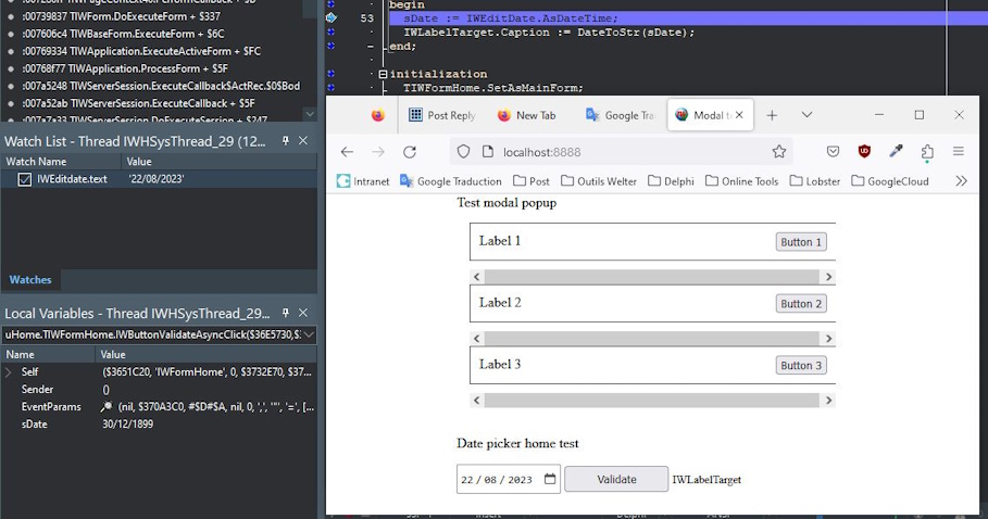

#7
Dear all,
Back again after few week without working on my project cause I have another problem with my modal.
Thanks to Alexandre, the render of the modal is what I want, but it doesn't work as expected and I don't understand why.
My testcase modal contains an IWEdit with data type stDate, an IWButton and an IWLabel.
On AsyncClick on the button, the selected date must be displayed in the label.
But when I test my modal, on click, the IWEdit text is always empty, so my label (or my variable in my real project) is empty.
I putted a breakpoint in my event, it's reached on click, but the IWEdit text is empty.
[Image: modal_eahoan.jpg]
For comparison, I created the same set of components (IWEdit, IWButton and IWLabel) on my home page, and in this case the IWEdit text is properly copied on click on the button.
[Image: home_q2yltx.jpg]
I don't understand the difference between the 2 cases and why my IWEdit is empty in my procedure even if I have a value selected in my modal.
I tried with a IWEdit with  data type stText, I have the same wrong result.
I already tried to use OnClick event instead of OnAsyncClick, but no chnage.
I also tried to encapsulate my 3 items in a form tag instead of a div and to assign manually the type submit to my button. In this case, when I select a date and press the button, the breakpoint is not reached and the modal is reset. At this moment, if I select another date and press the button again, the breakpoint is reached and the IWEdit text is available in my procedure. But not acceptable, I can't ask my user to do the job 2 times.
Hereby I join a new verson of my testcase, hope somebody can help me to understand what is the problem.
Many thanks for your help.

Hi Stéphane,
This was a tough one.
There is a bug when there are multiple levels of frames like this. We have already fixed the bug so the fix will be available in the next release.
There is an easy workaround for you, while the fix is not available:
After creating the IWModalCard you can notify the owner form directly that there was a change (i.e. you have created a control youself), doing:
IWForm.RehashPending := True;
In your project you don't have direct access to the parent main form, however you can obtain it using the owner of the TIWFrameCard itself.
So it would be like:
Code:
uses
  uHome, IWForm;  // add IWForm here
procedure TIWFrameCard.IWButtonCardAsyncClick(Sender: TObject;
  EventParams: TStringList);
var
  oModal: TIWFrameModal;
begin
  with IWModalCard do
  begin
    Reset;
    //use region from uCard
    oModal := TIWFrameModal.Create(Self);
    oModal.Name := Owner.Name + '_FrameModal';
    oModal.Parent := IWRegionCardModal;
    oModal.IWLabelTitle.Caption := 'From button ' + (Sender As TIWButton).Tag.ToString;
    ContentElement := IWRegionCardModal;
    Autosize := True;
    HasHeader := False;
    HasFooter := False;
    CloseButtonVisible := False;
    Show;
  end;
  // Add this new code
  if (Self.Owner is TIWForm) then
    TIWForm(Self.Owner).RehashPending := True;
end;
Please have in mind that after the update this workaround is redundant and should be removed.
Cheers
